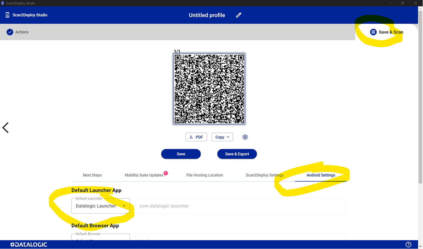

Can't setup datalogic laucher as default
Can’t setup datalogic laucher as default.
I have tried also setup via Scan2Deploy, but without success.

Hello,
You can find it here:
Best regards,
Maciej Socjusz
