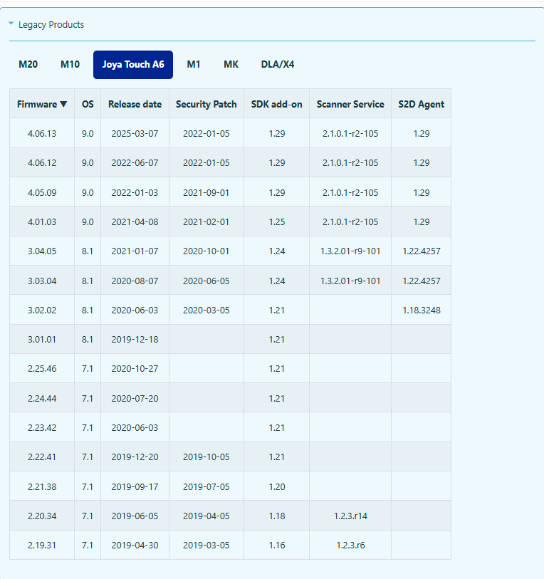

I saw that this was added in revision 40 on the SDK but I cannot find a way to find out which revision is running on the device to be able to check if the feature is available, is there a way of knowing this?
Hi @Vinicius_Oliverio,
You can check the version of the SDK here: Datalogic Android SDK | Technical Documentation
Since the A6 is EOL you have to look under legacy products:
