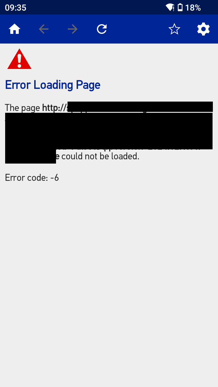

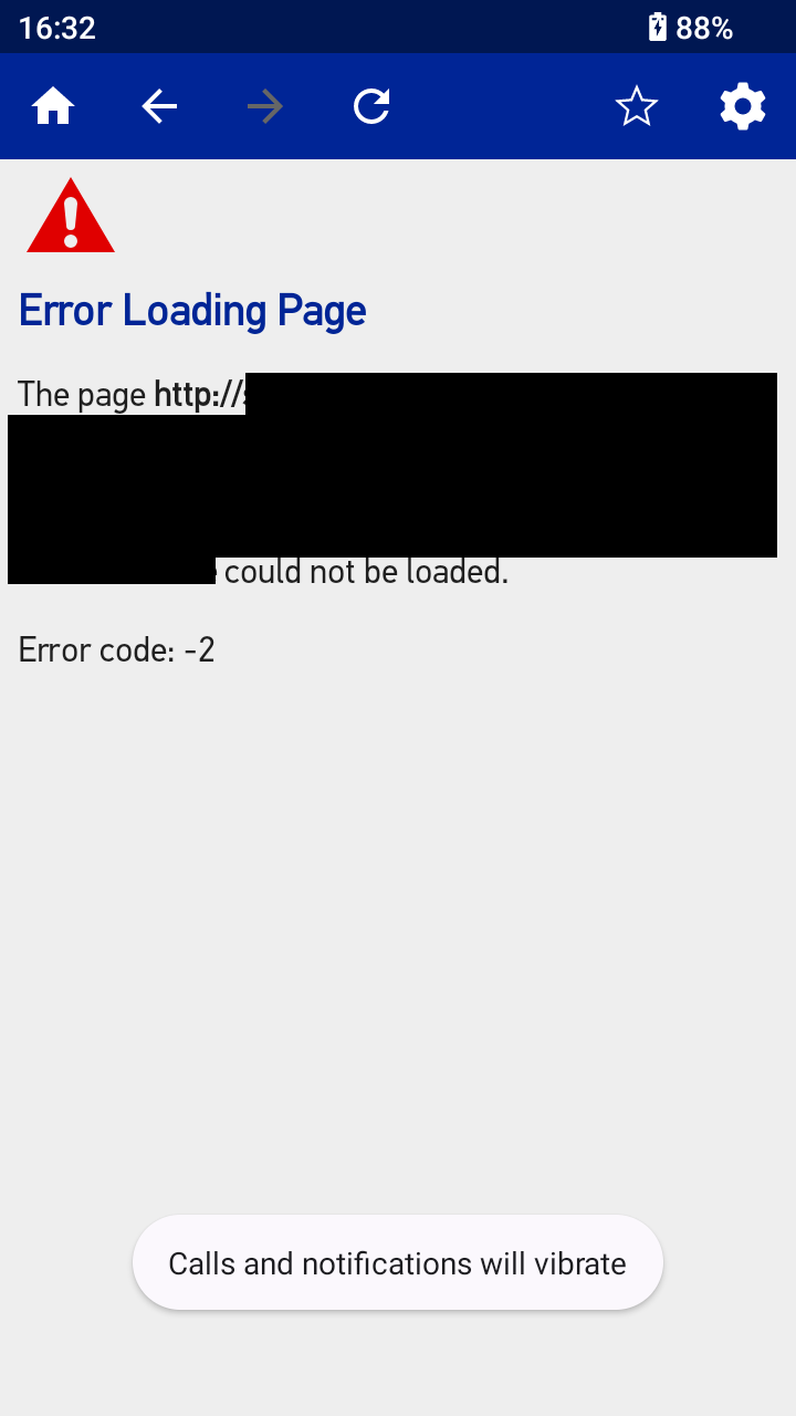

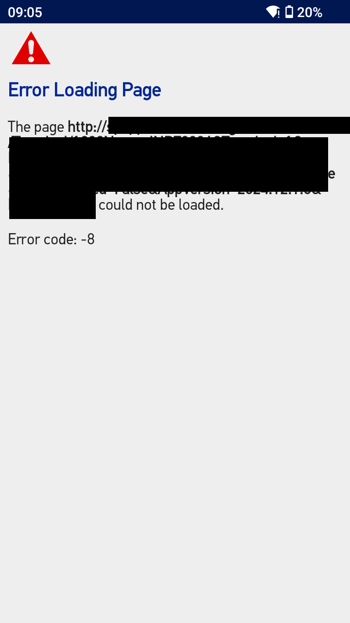

we connection problem with datalogic browser. The problem we have is that the webpage gives error after some time after the device sleeps ( Memor 10 and Memor 11 )
it gives some error numbers like:
Has anybody an idea how to solve this problem? And there is any config to force the page to refresh automatically? like every 20 seconds
Thanks

Browser error codes
At the same time, here are the meanings of the error codes you are receiving:
-2 = Server or proxy hostname lookup failed
-6 = Failed to connect to the server
-8 = Connection timed out
It looks like based on these codes the browser is not blocking the webpage in waiting for the connection. Looking at the Wi-Fi icons in the first two screen shots (and the lack of a Wi-Fi icon in the last) it seems more likely that you have a problem with reconnecting the Wi-Fi.
For this type of problem, the first recommendation is to also update the device’s firmware to the latest version available.
