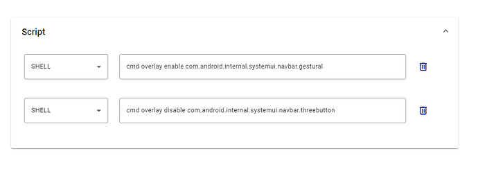

I am trying to deploy a change to a group of Memor12 devices:
Switching from 3-button to Gesture Navigation.
Over ADB, this comand works:
adb shell cmd overlay enable com.android.internal.systemui.navbar.gestural

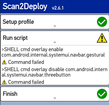

Scan2Deploy however throws an error:
Scripts:
Am I doing something wrong or is it not supported yet?

Currently, Scan2Deploy has security limitations that prevent the execution of the cmd overlay enable com.android.internal.systemui.navbar.gestural command you’re trying to use. While this command works perfectly through ADB, it’s not supported through Scan2Deploy at this time due to these imposed security restrictions.

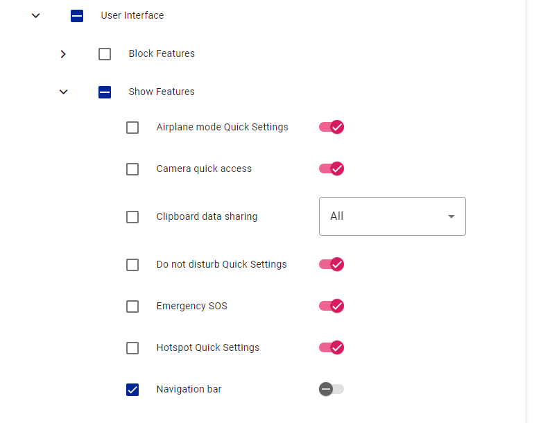

Just a tip if your only goal is to hide the navigation bar this could be done by the settings in Scan2deploy or Oemconfig:
