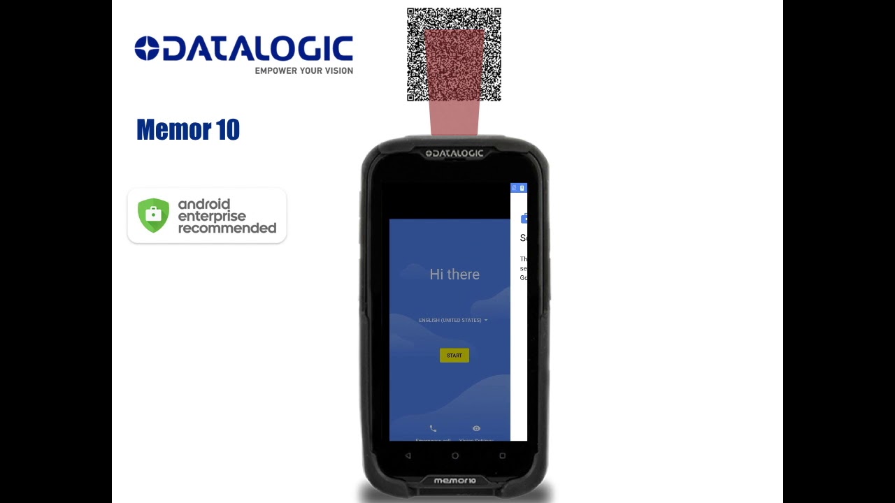

To improve the experience of enrolling devices into MDMs, Datalogic provides the “Android Enterprise QR Code Generator” tool, available here:
https://datalogic.github.io/aeqr/
At this link you can find all the related documentation:
This is the article we published when we firstly introduced the tools some years ago:
This quick video shows the tool in action
If the information you find in these pages is not enough, please create a support ticket and we will work with you one on one to resolve the issue.

The Joya A6 collectors do not have the Android welcome screen to carry out the procedure sent, when I reset to the factory, the Android home screen automatically appears, this is being the greatest difficulty to carry out the registration, we are using the MDM Soti , is there any other method?
Hello @Fabricio_Leite,
It sounds like your device is on an earlier firmware than 8.1 .
The Joya A6 did not have setup wizard (Hi there…) until Android 8.1 .
However, Joya A6 was bundled with SOTI MobiControl.
You would need to use the SOTI Mobicontrol app to enroll.
If you need functionality supplied by enrolling from the Hi there screen, you would need to update to 8.1+
A lot of the documentation online only covers how Android Enterprise behaves currently.
You may find enrolling via the app satisfies your needs, even though newer documentation suggests enrolling from the Hi there screen is required.
