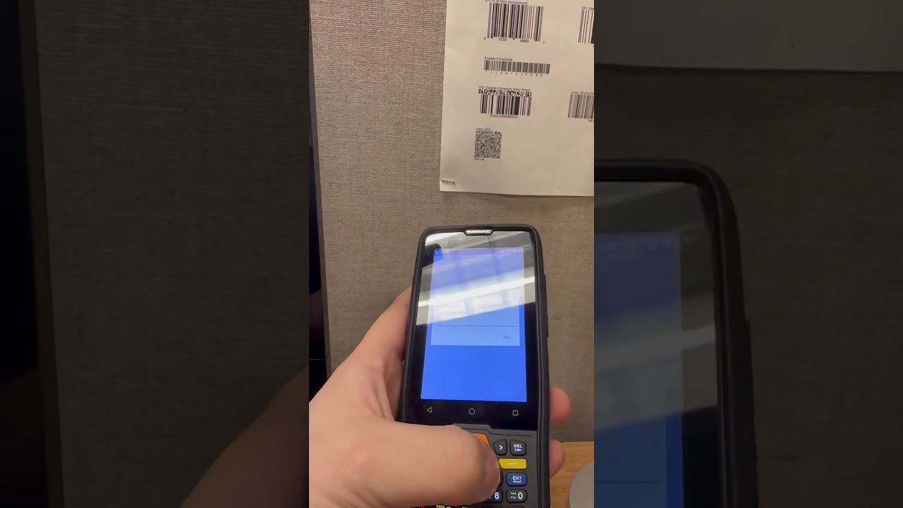

Most often the issue occurs, when I point the scanner away from the barcode, press the [Scan] button, and while holding it, point the beam at the barcode.

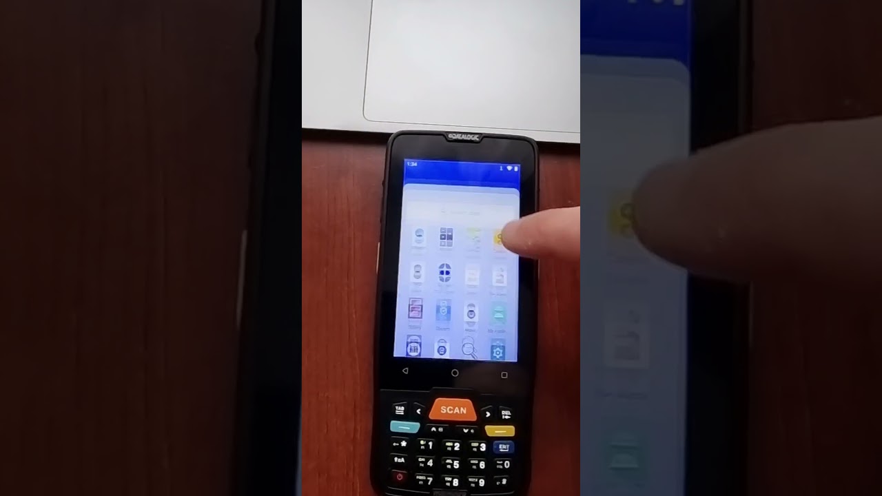

Hello Andrew,
I ran your code on my end and was able to reproduce the behavior you described.
But, when I disabled the keyboard wedge and removed the barcode suffix, it corrected the issue.
Here is a video showing the Memor K behaving as expected, after changing the settings.

@Drew_Hugentobler,
Please try the following:
It is not always possible to scan a barcode the first time. Then the error appears:
