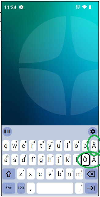

Hi,
How can we configure QuickBoard (using Scan2Deploy) with a Nordic QWERTY layout with 11 keys in both upper rows – i.e. Å after P and Ö & Ä after L? The layout configurator gives an error “Too many buttons in the row. Cannot have more than 10 buttons.” even when setting the per-key width to 0.9.

Unfortunately, the maximum number of buttons in QuickBoard rows is ten, as you discovered. Although not the standard in Nordic countries, you can add extra rows so you can add the letters with diacritical marks on the extra row or rows.
Let me take your question to our developers to see if we might be able to extend this number of characters per line in the future. Sorry that we don’t accommodate this at the moment.

I spoke with the lead developer of QuickBoard, and he said that he set the maximum number of keys per row at ten because with eleven or more, the keys started to clip the letters displayed on them even with the narrowest gutter between the keys. I can see what he means, given the way he rendered each key on screen. He said the other limitation is the horizontal resolution available on most of our products’ displays.
Despite this, I’ll write a feature request to add more keys per row. Decades ago I was a graphic designer, and I can imagine some visual tricks that might allow clear presentation of more keys per row without clipping the graphics on the keys.

I wanted to let you know that Scan2Deploy Studio now supports adding an eleventh character to every line, as you requested. This is supported in Scan2Deploy Studio 2.7.0 and newer. Please try it out and let me know if it meets your needs.
