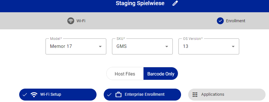

has anyone recently tried to enroll SOTI MC on Android 15 devices? It worked fine with Android 13 but after an update to Android 15 on my Memor17 it wont enroll until I change the settings to OS 13

What do you mean with change the settings to OS 13? Do you mean the setting in Scan2Deploy Studio?

Welcome to the discussion board. There is a chance that you don’t see Memor 17 Android 15 because you are running an outdated version of Scan2Deploy Studio. If you right-click on Scan2Deploy Studio’s task tray icon, you should see a menu appear. Select “Check for update” and Scan2Deploy Studio will check with GitHub to see if a newer version has been released than the one you have installed, and if a newer version has been released you will see a prompt to upgrade.
The current version as of today is 2.6.3, and it displays both “13” and “15” in the “OS Version” menu for Memor 12 and Memor 17.
