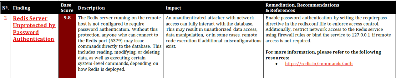

I have a customer with numerous Memor 10 devices. I set them up with scan2deploy studio to allow app updates across their estate.
however now their IT department is saying that “redis server” - which i believe is a component of scan2deploy studio, is a security risk. i have pasted the detail below.

Hello @David_Gates,
We have updated Scan2Deploy to address this issue.
Look for v2.6.3 on GitHub, it should be out tonight or early tomorrow.

Hi Drew
Many thanks for this.
i’ll give it a go
