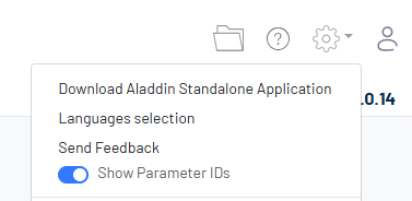

Unfortunately, there is no such folder. What am I doing wrong?
I don’t know. Have you installed the Aladdin application on your pc?
In any case you can also create a case via our website. We can always e-mail you the latest firmware. You can create a case here: Technical Support - Datalogic
