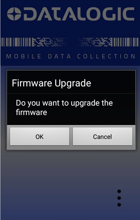

The only thing the intent script did was to wake DXU up, where the following box appears:
If you select “OK”, nothing happens on the device, i.e. no update occurs.
