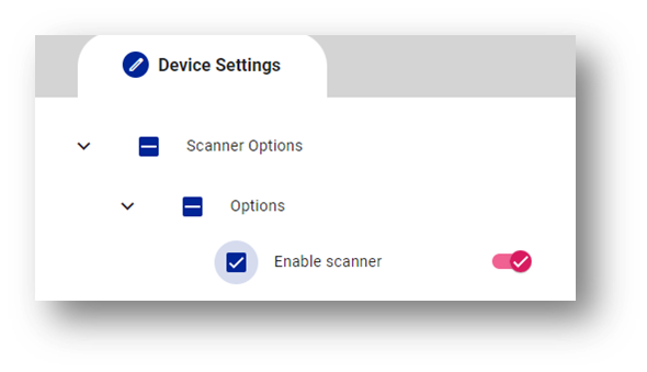

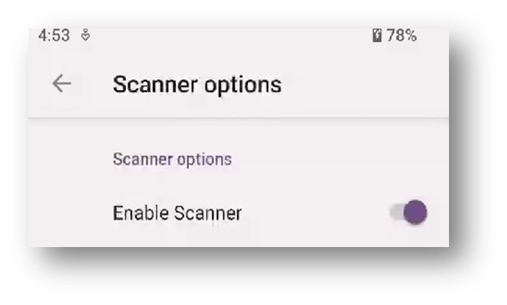

To manipulate ENABLE_SCANNER property, there are several options:
  • Option A - Through “Datalogic Settings” menu on the Device UI, under “Scanner Options”
  • Option B -Through Scan2Deploy or MDMs:
